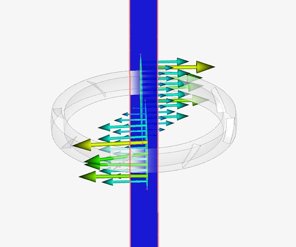

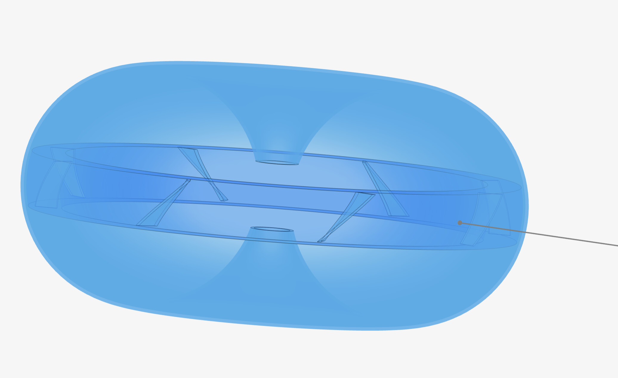

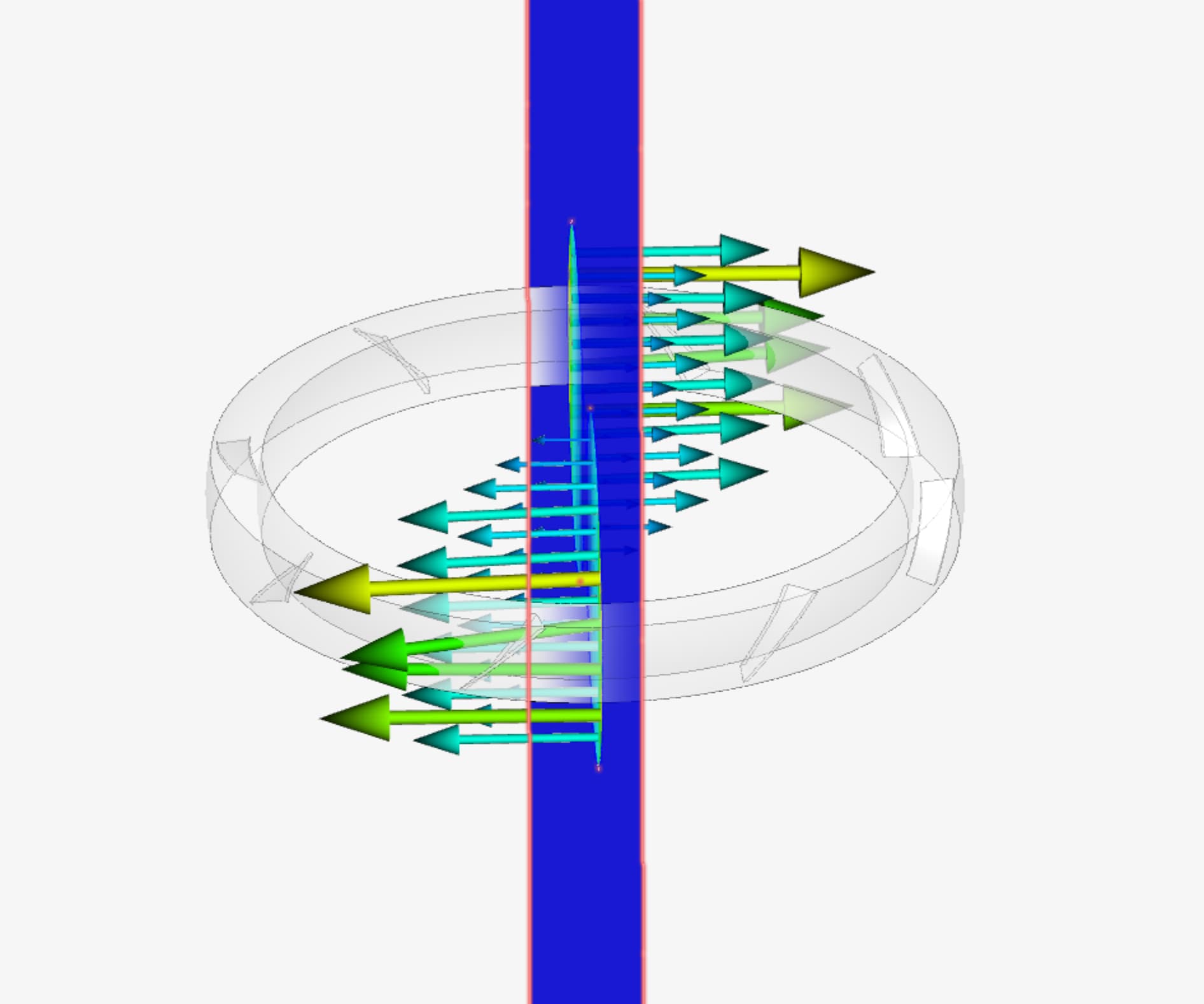

I’m trying to rotate air blades inside of shell (torus shape). But simulation get me only rotating in XY axis, there are no vertical (Z-axis) air movement at all.
I tried to make blades as slip walls, as not slip walls, not walls at all. Changing RPM 100 - 5000. Same result

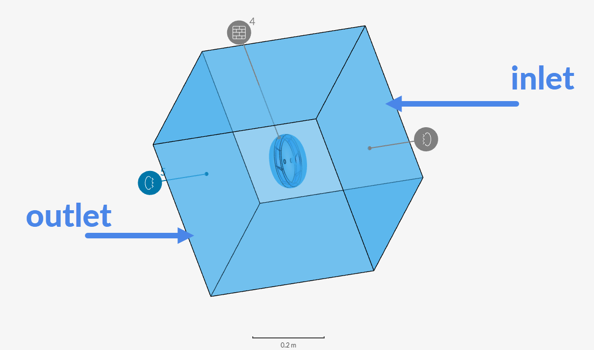

apologies for the delay here, it’s been a busy week. I guess you could try two things:
  1. Apply a velocity inlet/pressure outlet to the upper/lower faces
  2. Follow the setup in this tutorial for a drone airflow analysis: Rotating Zones Drone Simulation | Tutorial | SimScale

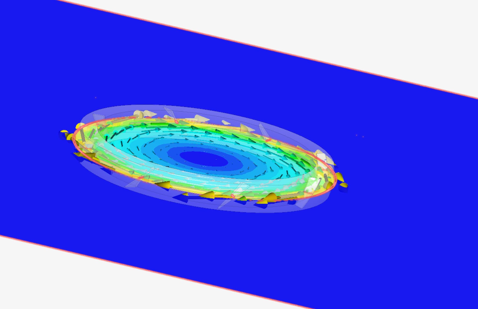

Didn’t help. Also I see strange particle trace:
