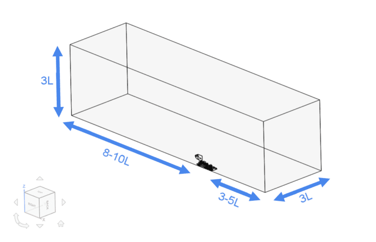

So there is no general rule to that.
I usually try to stick to these dimensions.
But you can always have a look at the flow field and check if you have a normal flow, like the inlet conditions. Then you can cut off the wind tunnel.
Best regards Sebastian
