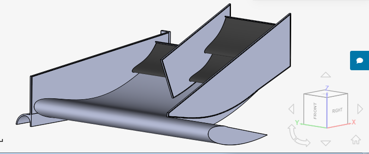

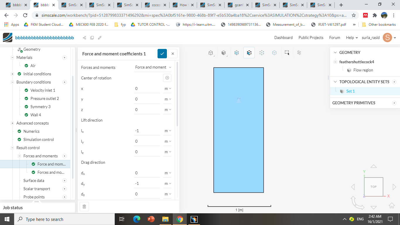

Hi, Im still new using Simscale. From the picture we can see that the axis direction for lift should be in postive direction. However, if i put 1 to the lift direction the result will be negative. Is there any problem with my simulation ? I hope someone can help me

You can set the desired lift direction to whatever you want. If (+x) is your lift direction, then having a negative result is completely fine, This is what i normally do for Downforce Results. SO i set lift to +Z and my results are negative
Dan
thankyou for clarify this issue tu me!! it does help me
