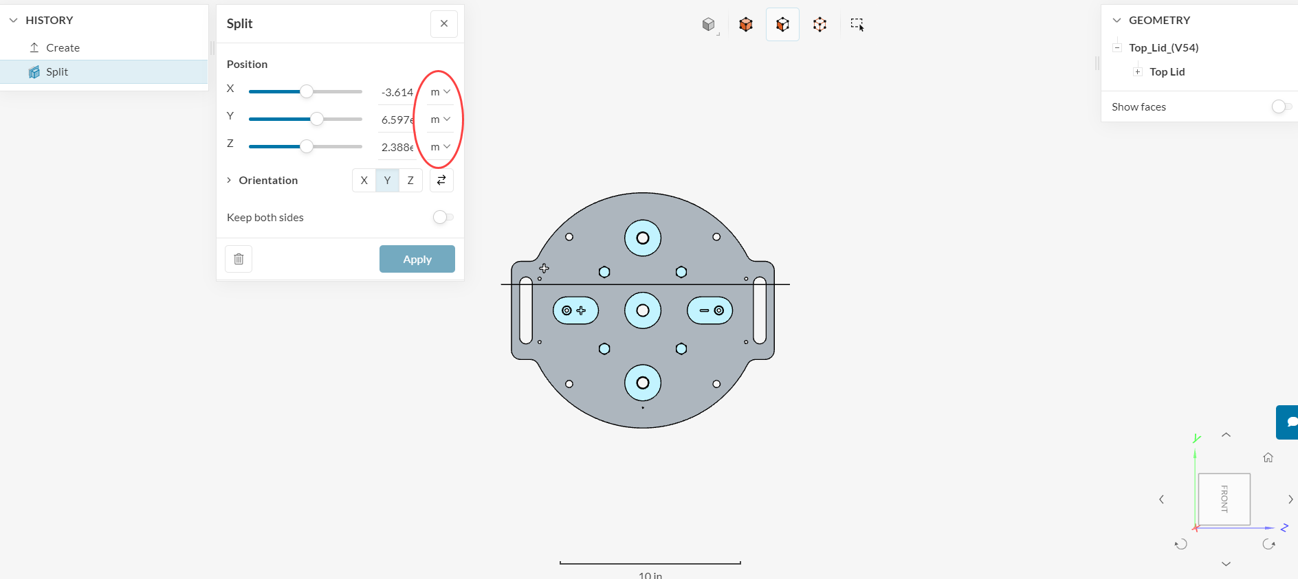

Using imported Assembly from Onshape.
Splitting plane shows up in middle of body initially, which is great, but after split operation the body is not split in half. And it’s seemingly not possible to move splitting plane.

Hello @dolender,
Thanks for reporting, it looks like a small bug, can you try to adjust the units to meters instead of inches?

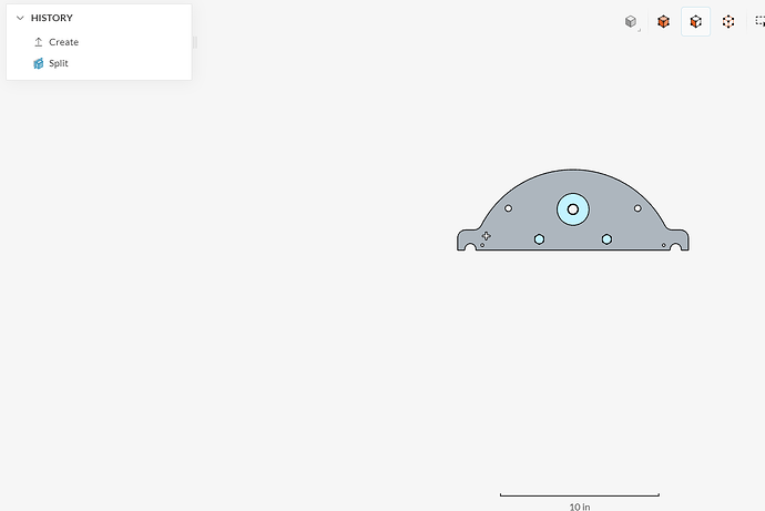

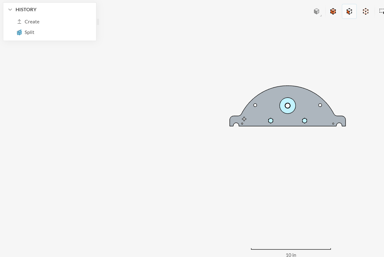

By turning “Keep both sides” off, you will get the expected result:
Thanks Ricardo. That worked!
