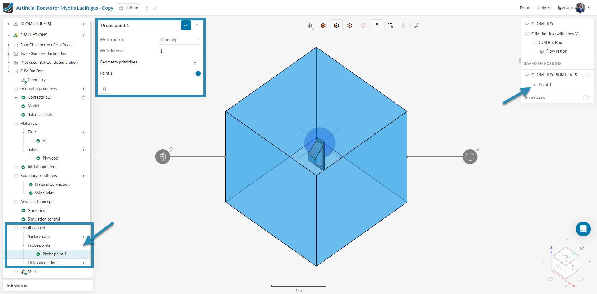

I think what you’re looking for are probe points:

Can probe points be randomized? IfI just create 40 probe points that wouldn’t accomplish the random aspect of what I need.
Caleb
Hi Caleb,
Unfortunately not, there souldn’t be a way to do that within the platform. But you can suggest that over at our RoadMap!
Maybe you can try doing that in a third party solution and then type in the coordinates manually for each probe point
