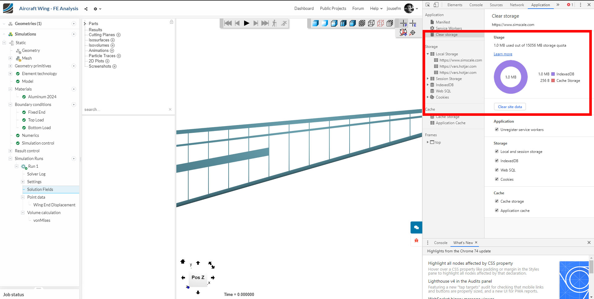

This should definitely not happen in the first place - a “quickfix” for this can be done as follows:
Open Developer Tools in your browser and go to Application. For me clearing the site data resolved the issue.
Alternatively one needs to delete the config attribute in the local storage of the browser!
Let me know if that helped!

Thanks, that worked :smile:
