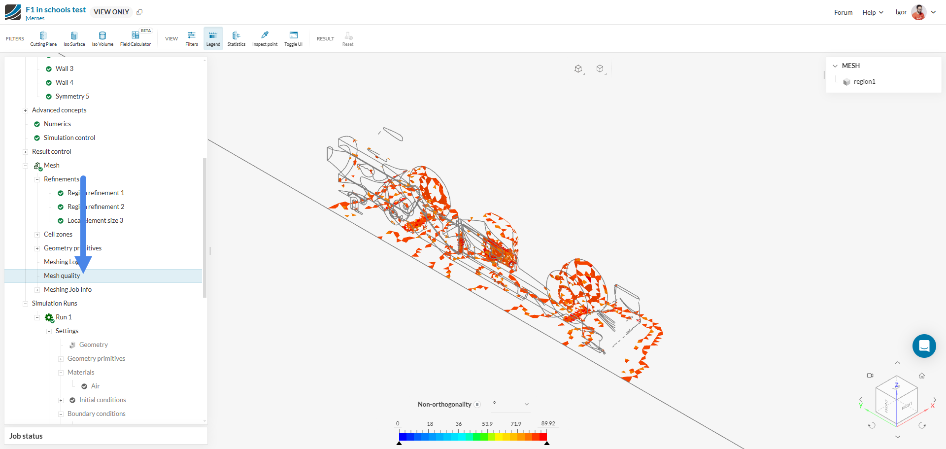

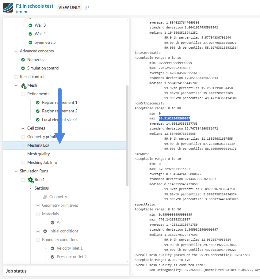

As a sidenote, it’s better to simply remove these problematic issues in a CAD tool instead of having them fixed by the Small Feature suppresion. Looking at the meshing log, the Non-orthogonality for your model is still pretty high and this will likely lead to instabilities in your simulation.
Going to the Mesh quality viewer, you’ll be able to spot potential candidates for cleanups:
