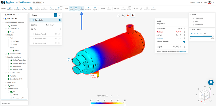

Hi @dafna, thanks for posting on the forum and welcome to the SimScale Community :handshake:
To have this in an automatic fashion, I guess a third party post-processing tool (such as ParaView) would be the way to go at the moment.

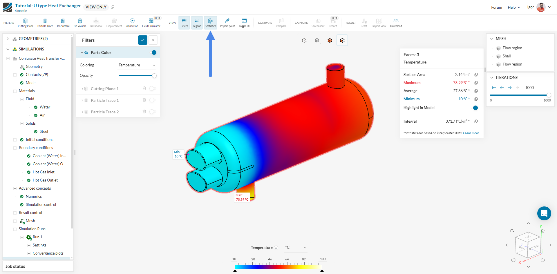

However, if retrieving these values manually would be good enough, you could use the statistics filter to retrieve the volumetric maximum/minimum parameters within your results:
In regards to retrieving the average heat transfer coefficient, you’d need to set it as an additional field result (take a look here).
