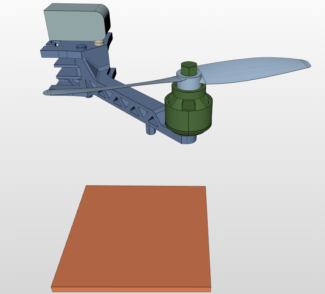

Geometry:
Due to symmetry of the model, only quarter of the model was taken in to consideration for the analysis. Doing this helped in reducing the mesh size and thus computation time. The quarter model is shown in the figure below.

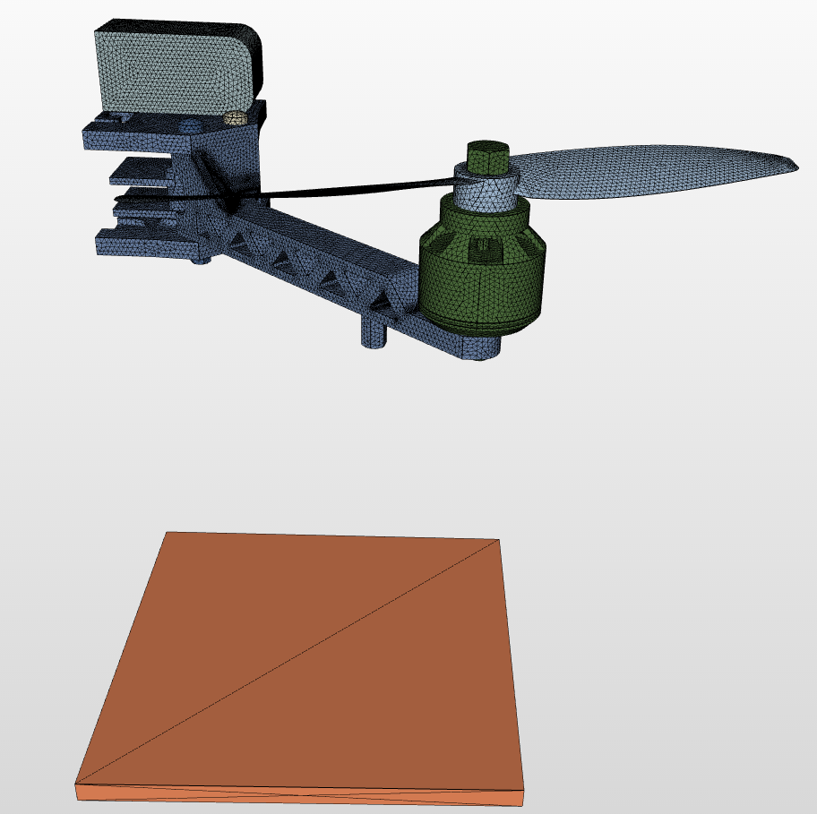

Mesh:
Tetrahedralization with refinements was used as mesh algorithm. Two types of mesh were made; moderate and refinement. Some of the curvatures were refined in order to capture stresses more accurately. The refined mesh is shown in the figure below.

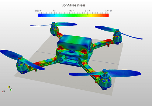

Results:

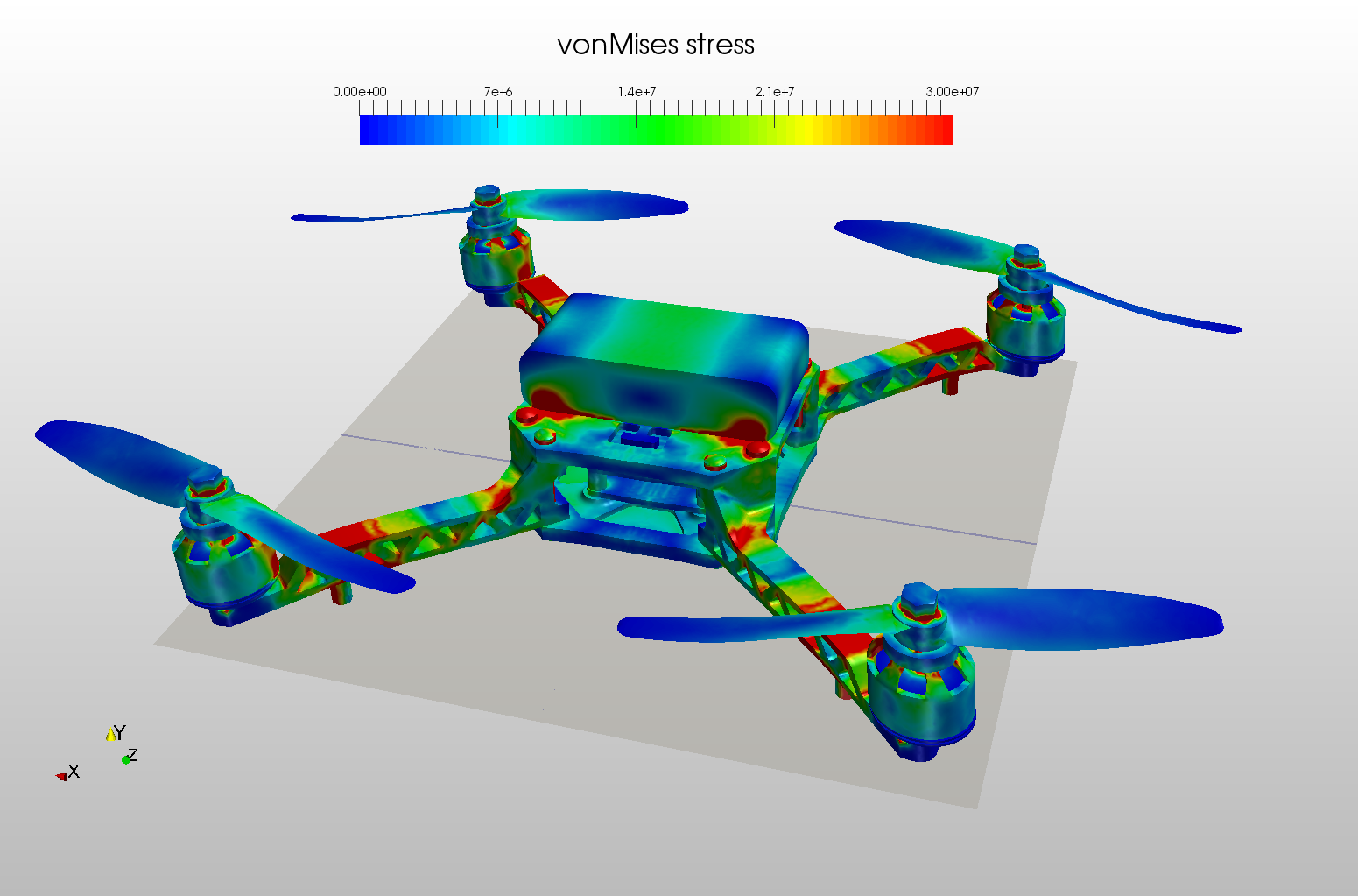

Interval: Maximum Impact

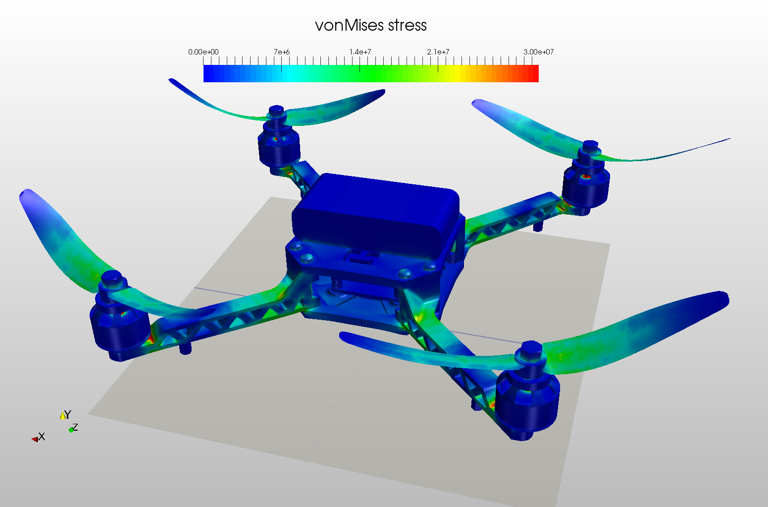

Interval: Just after the Impact

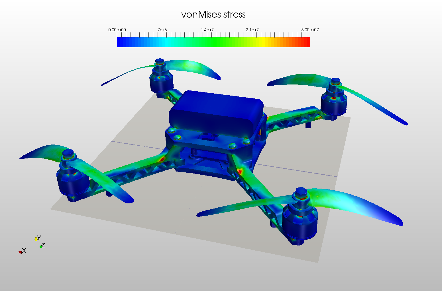

Interval: Final stage
Animation
