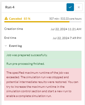

i mean the simulation is not running until finished. I have already used maximum runtime 30000s and 500 iterations
Could you also share your convergence plots?
The issue is that you ran out of runtime and are not achieving complete convergence, which causes the simulation to keep running until it converges or the runtime is consumed.

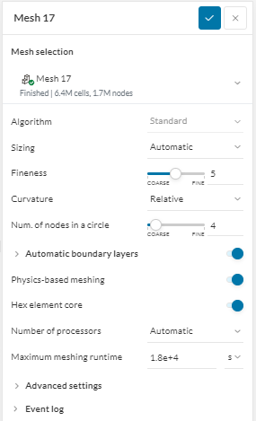

It is very difficult to give you further feedback without more details about the project. In my experience, for large meshes, using automatic sizing is not recommended, as it wastes resources by overrefining where it is not required and underrefining where a high-quality mesh is needed. This can result in divergence and stability problems, which can also cause your solution to fail to converge.
