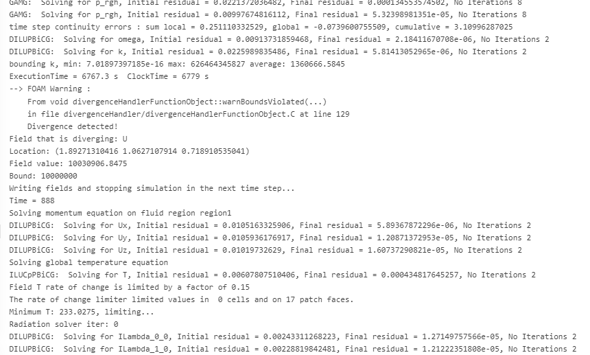

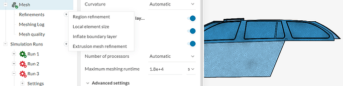

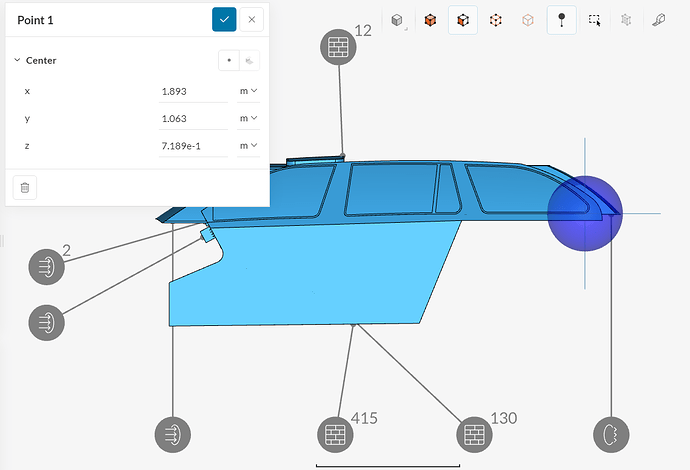

I’m consistently having my simulation diverge at the specified coordinates in the screenshot. How can I fix the divergence at that specific point? How can I refine the mesh in a specific area? I have attached a screenshot of the divergence notification, the probe point I have created based on those coordinates, the solver log section where divergence starts, as well as the options that appear in mesh refinements.
I would appreciate detailed information on the refinement process, preferably multiple possible solutions that I can try out.

Velocity divergence issues are very common and have been resolved in many other forum chats.
One of them is here:
You might want to create a geometry primitive around that region where you have a probe point instead. And add a mesh refinement to that primitive.
Let us know if you have more questions.
