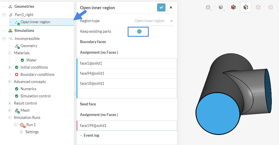

Basically you have 2 regions (walls of the pipe + flow region). An incompressible analysis requires a single region (namely the flow region).
To solve this issue, simply toggle “Keep existing parts” off, re-mesh and run the simulation.
If i do that i will face another problem with meshing!!!
I did that already.
