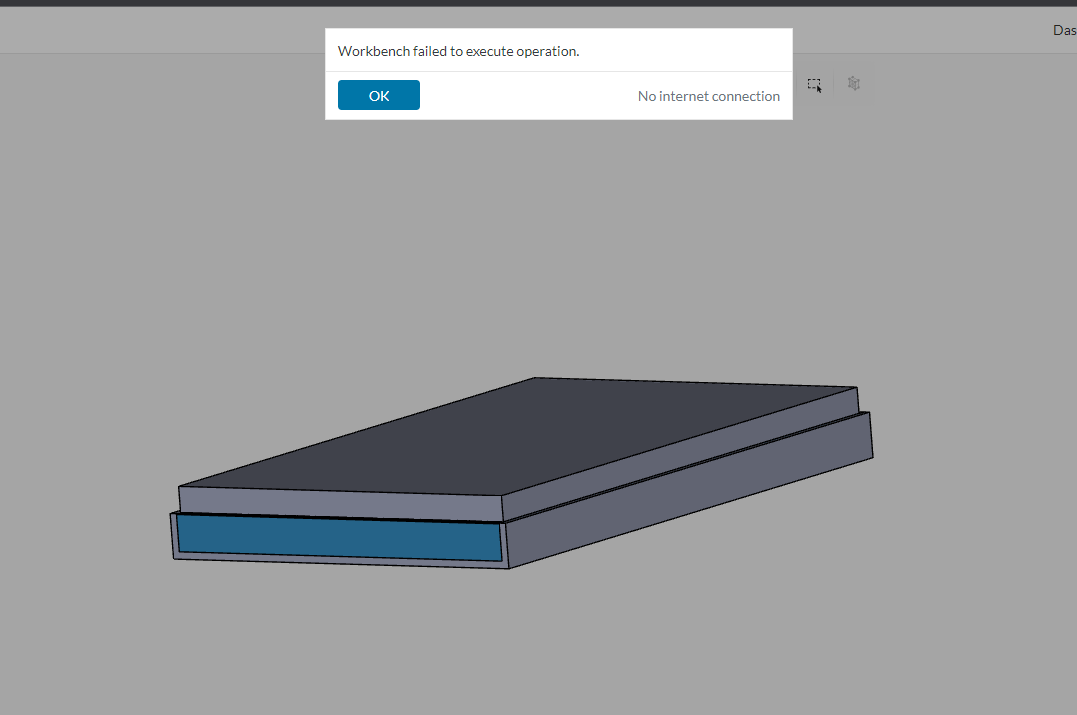

want to ask i want to restart my simulation after no progress after so long. but then when i want to do a new run if apppear a message that said workbench failed to excecute operation altough i have stable internet connection. It also apprears same message when i copy my project. Pls help me as my project submission is almost near. i really need to have the simulation result

Hello @tpade , this is currently a known issue when there are large number of contacts in simulation setup, and it’s currently being worked on by the development team.
In the mean time, you can try decreasing the number of contacts and domain size to achieve successfull simulation runs. Please take advantage of your geometry being symmetrical if possible, this will significantly reduce the number of contacts and domain size. Try merging bodies that are made of same materials instead of using contacts between them. Start with a mesh that is as coarse as possible and continue refinements if necessary one by one.
