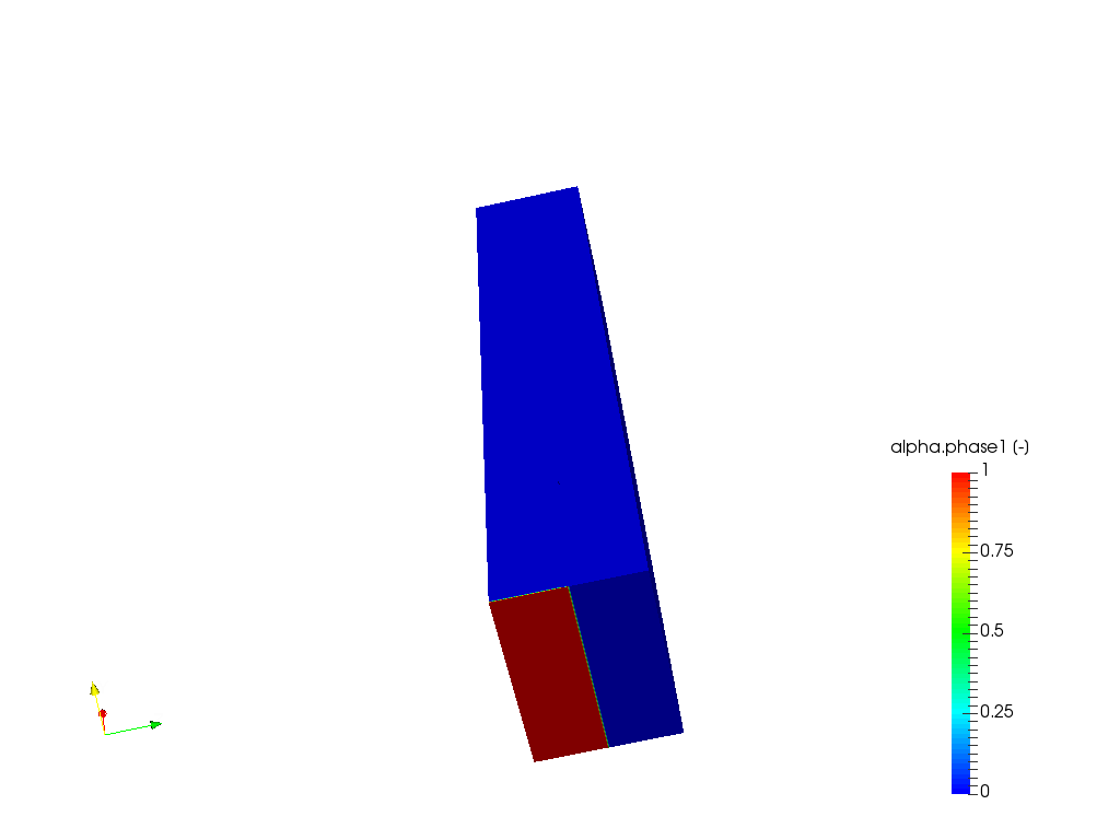

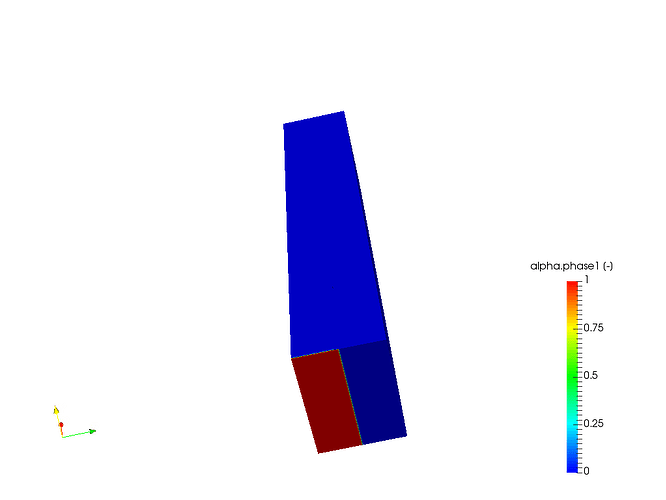

Hi @cecil_pabbathi, mixed report. I know what the problem is but haven’t had success at the moment in fixing the issue, I hope I might have some time to look later but here is the issue:
As you can see this shows your phase fraction, and that sub-domain based initialisation seems to not have not worked for some reason.
If I figure out the reason I’ll let you know.
